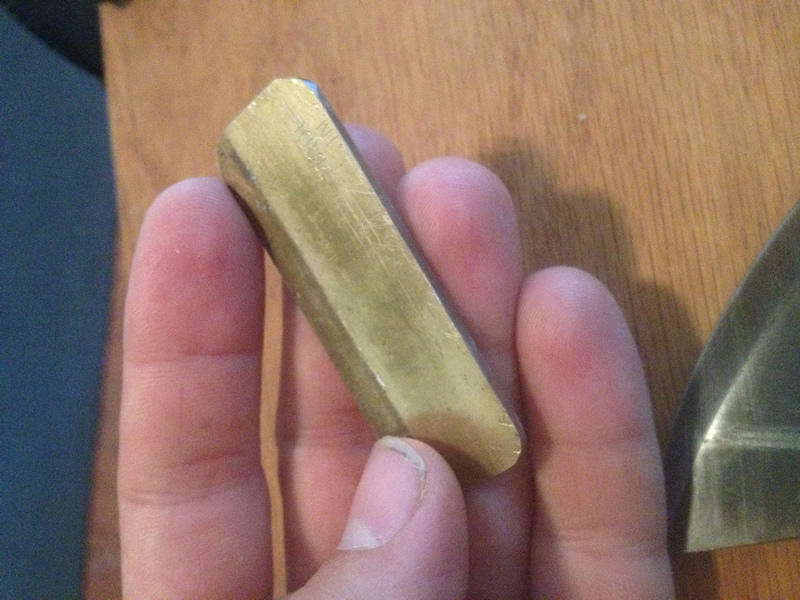

I am putting a crossguard on a modified ontario machete, and I found a half of a door hinge that was just the right size and thickness.
It looked like it was brassy or bronze at one time, but when I started cutting it was shiny bright silver on the inside, and the brassy color was just a coating.
Anyway, it's much too heavy to be aluminum. The hinge half said "Made in USA" and STANLEY and it is probably 10+ years old.
What I'm wondering is if it is stainless steel, nickel, zinc, all of the above? Any reason not to use it?
Probably mild steel (1018) with brass plating.

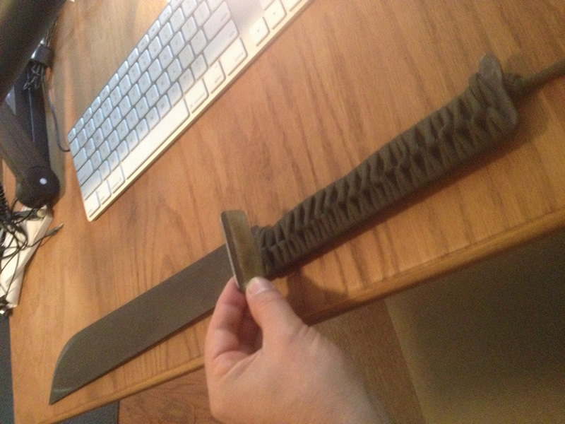

Thanks, that's what I'm thinking too. I guess it will be fine as a crossguard as long as I fit it first then put some kind of patina or browning or blueing on it before fixing it in place with epoxy.
Here's a couple of pics...
The bit cut from the old door hinge:
...and held up to the modified Ontario machete:
It will be the cheapest mild steel the company can have them stamped out of. No way to know exactly what the steel is. It will be 100% assuredly NOT a knife steel. For a guard or fitting, it should be fine.

If you ever have that question in the future, a magnet will tell you the answer quite often.
I came to this thread to mock you, but after reading it, this is actually pretty reasonable. :D
It's not stainless steel, nickel, zinc, because those are either too expensive and/or too weak for this. Stick a magnet to it.
It is most likely A36, which is an inexpensive mild steel available in coils that can be fed through the press and stamped out.
Any reason not to use it? Nope, go nuts. :thumbup:
It's probably mild steel with brass plating like the others said, but I've had hinges which were actually solid brass. The magnet will tell you.
