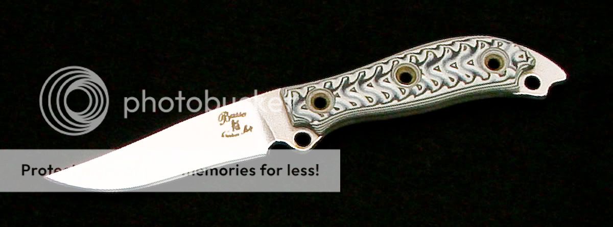

Depending on the blade width, maybe a custom Meaner Street...? Here's a pic of one style of variant:
Or a regular style Meaner St in a D/C finish., 3rd in from right side:
Anorexic Badger Attack LE, though it's not flat ground.
Second from the top in this picture...
The other option that came to mind is the Meaner SE that Jaxx mentioned.
IIRC, Jerry doesn't really have a knife that matches all requested characteristics. The closest that I can think of would be a Basic 5, smooth coat but it is thicker than 3/16" and is coated (black). However, it is flat ground, has a small choil and the blade length would be about 5 1/4". Good luck. Basics out of production since about 2001 and more than a few looking for them. (I'm one of them.) Pete
