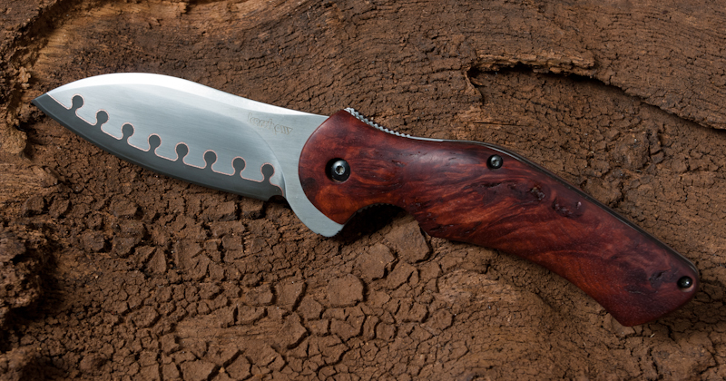

Nice to see wood scales on modern folders. This is a rare example of a modern-looking folder I'd consider purchasing!
Agreed. Sadly, it doesn't come from the factory like that.
