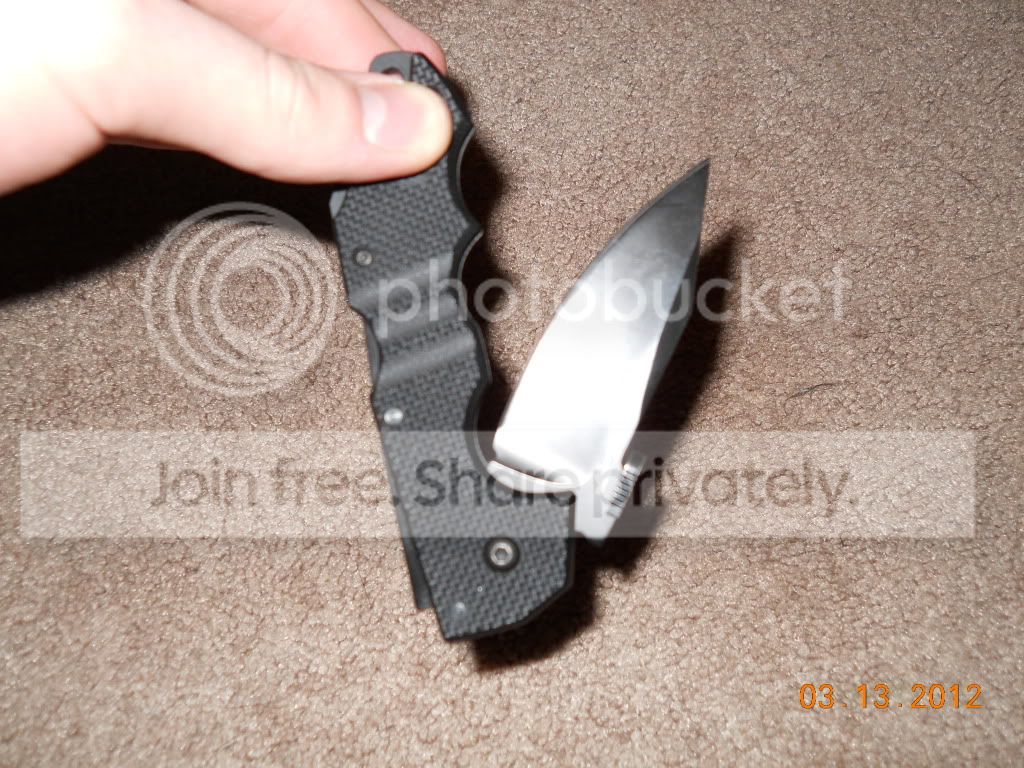

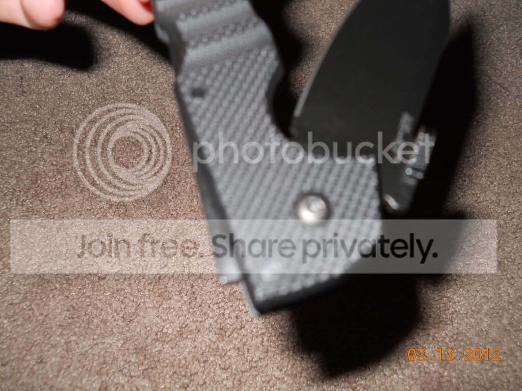

knife is closed and the lockbar is out
the blade IS NOT balanced open. from closed, to this point, the blade is loose when the lockbar is stuck
close up.
the knife WAS NOT ABUSED and i babied the heck out of it. carried it for 2 months, and this happened all on its own. to "fix" the lockbar being stuck, it must be slammed closed. being sent out tomorrow. wish me luck :)

looks like your lock spring broke/slipped loose... can we get a pic looking directly down between the scales?

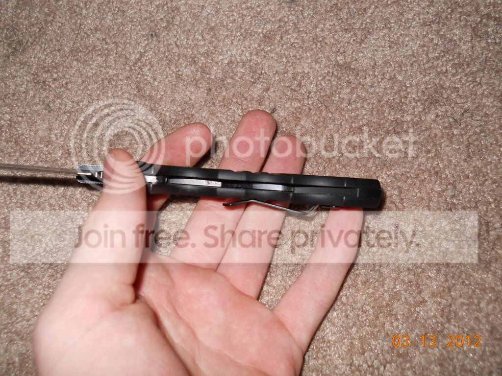

heres between the scales. SPRING IS NOT BROKE.

hard to tell by looking at the pic if your lock spring has slipped foward oris still there lol. cs customer service/warranty is pretty good. you should have a new knife in a 2-3weeks
yeah. i hope so. ive checked it all out. it still locks open great. the spring is still there and intact. i read a thread about an "unseated leaf spring". i think i have that. got my letter, box, receipt all ready to go. goin out tomorrow
I am not familiar with how the lock spring is secured on the mini AK. Some knives use mechanical fasteners, some use spring tension against the back spacer. The only way I can see this happening is if your lock spring has come loose from it's anchoring.
Let us know if Cold Steel tells you what happened.
from what i know, it uses a pin to keep the bar there. this pin has extra room around it, so when the blade is struck on something, the whole peice moves instead of the lock snapping. when this happens, the leaf spring slides up, and the bar hits on the tri-ad-lock's stop pin. but, im my case, i didnt abuse it. it moved all on its own
Yeah, I'm sticking with a defect in the spring anchor. The lockbar looks fine, but the spring that tensions the lockbar came loose, somehow.
I'm also going to guess that CS will say this is a factory defect, and replace it for free.
If they don't, you need to make a lot of noise!
