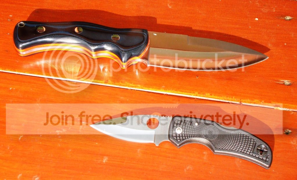

This is what my Native wants to grow up to be! Not disparaging the Native, it's a great little knife I recently added to my collection. Scary sharp out of the container. The fixed blade is the "Combat Survivor" from KnifeKits.com, shaped like a large, fixed Native. Scales are blue and black G-10 with orange G-10, stainless steel corbies and lanyard tube. The color scheme was more of an experiment to see how well epoxy would hold the G-10 together, and it seems to have worked out well. I sold it to a friend, so I'll see how it holds up long-term once he starts using it.
amen,
Yup, it is a beast! Specs are:
Blade Steel: AUS8 (Heat/Cryo-Treated)
Overall Length: 10.25"
Blade Length: 4.75"
Blade Width: 1-5/8"
Blade Thickness: .178"
Finish: Satin
I don't know the weight but it weighs a ton. My friend who bought it is going to order a sheath for it.
