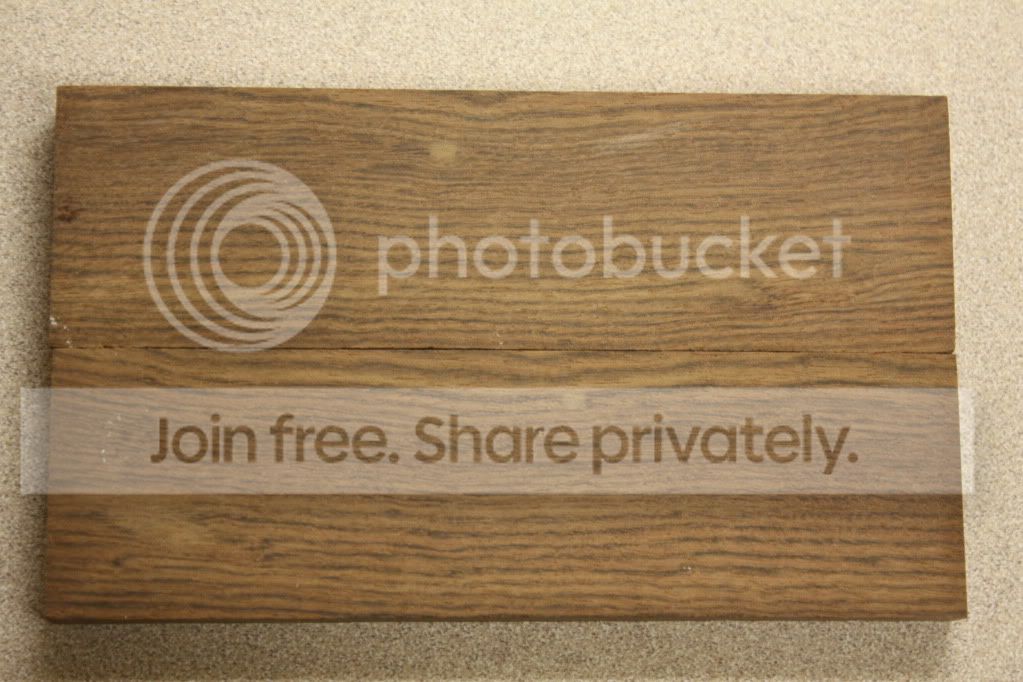

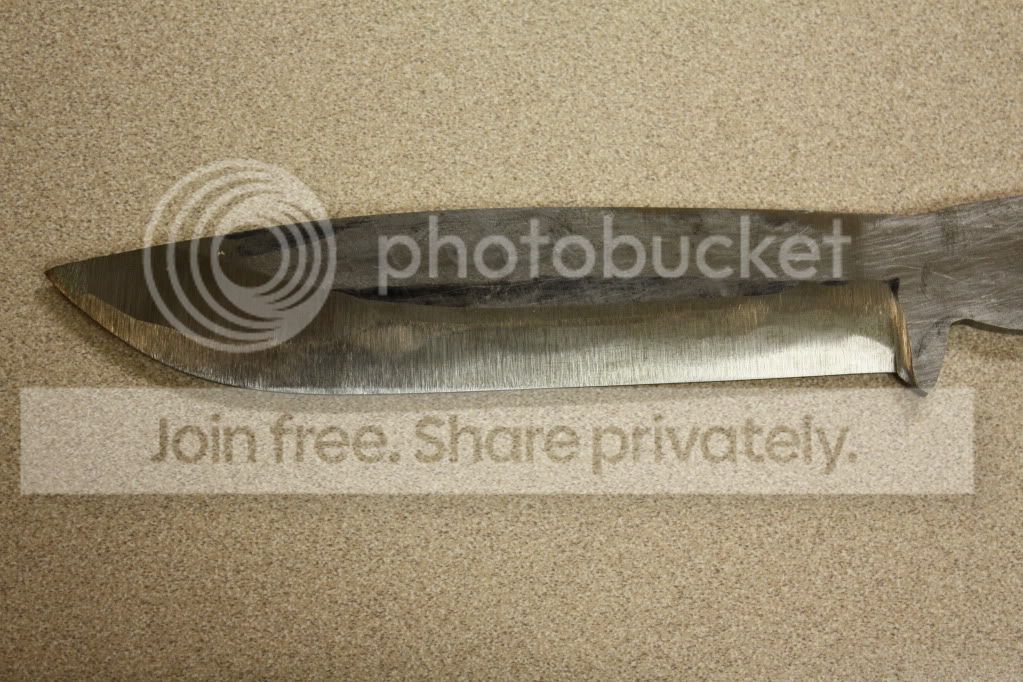

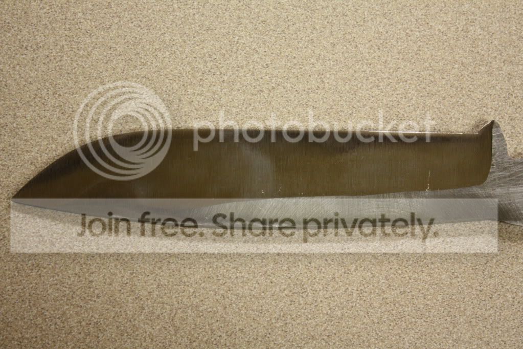

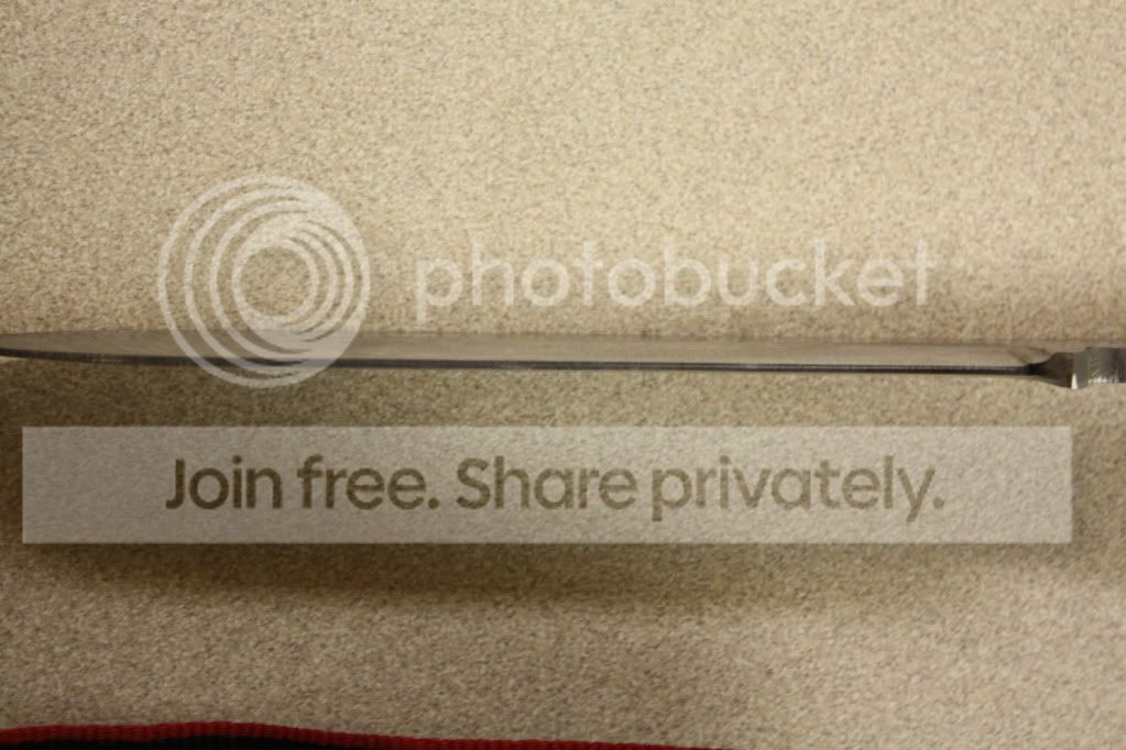

I have been trying to get started in knife making and made a couple out of files by hand tools. I woke up this morning and this is what I unwraped. I began using it today and I love it. I just wish I had more belts besides the one 80 grit it came with. I guess I need to order some more belts. I started working on a camp knife I am making out of 1095. I still have a lot of work to do. What dou you think so far honest critizem please. By the way got my first cut today but learned a very valuable leason. Be sure you are in postion before setting th steel to the disk sander. The steel was snached right into the sander. I got left with the cut in the pictures. It wasnt to bad bout 1/8 inch deep. What do you think of the this wood for the scales?
Good for you dude.Sure beats files.For your first grinds they don't look bad.The wood should look good on it.

It sure does beat files. I still have to work the bevels some to even them out. the finger groove still needs some work. I was thinking bout ordering from true grit. I not sure what the wood is. I think it is suppose to be cocobolo. I got a package of scales 3 years ago and cant remember what they were. Any one have a input on what the wood is.
