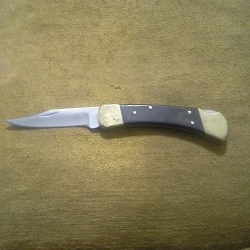

I saved my pennies and bought my first Buck 110 in 1983 from an Ace Hardware store for $35. The scales are jet black wood, I've searched around as best I can and can't determine what they are.

should be macassar ebony, started radiusing, I believe toward the end of 3 dot cir 1981(may be wrong there) and all 4-dots 81-85.
Welcome to the Bladeforums Phillip , I would really consider sending it Back to Buck for the spa treatment and if it really needed a new blade the will do it for you , or maybe the tang could be ground down a little to bring the tip down into the knife when it's closed . As for a new sheath the new black sheaths with the black and white snap are very soft or find a vintage one online . And always remember we like pictures so if you can show us a picture of your knife like a before and after pic would be great . Enjoy your time here .
Thanks for the welcome. I guess it sat on a shelf for a few years, according to the sticky, it was made between 74-80 since it has two dots. Is macassar ebony black?

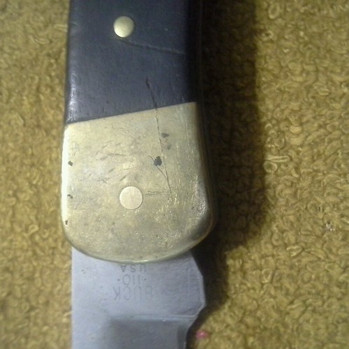

Phil, Welcome to the Buck Forum. Yours is not radiused. Macassar ebony can be dark, yours may become lighter if cleaned. The 2 dots ran from 74-79, depending on who's doing the presentation. Yours having that pin configuration would be the last date. The blade is 440C and Buck doesn't do reblades of different steels, only 420HC. Yours would clean up handsomely. DM

I'll clean her up and post better pics, but I bought this knife new when I was 13, the scales are black as the ace of spades and always have been. Even where I nicked them once, it's black underneath. The knife was $35 in '83, which was a good bit of money then, I wonder if it was that expensive due to it's black grips? Then again, an Ace Hardware has never been the low cost leader in anything, lol!
Your welcome. No, you cannot get a re-blade of S30V nor 420 in black oxide. Only the standard 420 and it has a satin finish, perhaps a step higher. Cuts of that wood can run black. I'm not saying you didn't purchase the knife in 1983. I'm saying your 110 was last mfg. in that manner in 1979 (give or take a few months). Who knows how long the New 110 sat in a display case at Ace Hardware, before you came along. DM
