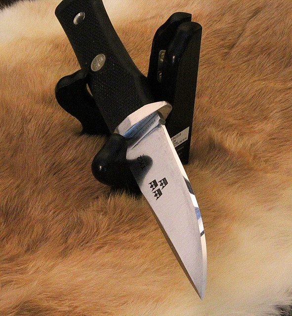

Stitchawl
I have been using the Wicked Edge Precision Sharpener for over a year now and I couldn't be happier. The edges are frighteningly sharp every time and touch-ups are a breeze. The knives are held firmly by its clamp and the precise position can be accurately repeated easily. Angles cane be set very precisely.
The selection of stones for the double paddles include diamond, Shaptons and Choseras...there are also leather and balsa strops with a fine variety of sharpening compounds to use with them
Here is my TK2 Fallkniven knife with a 3G Powder Steel laminate blade done with Shapton Stones on the WEPS.
Sorry for the quality of the shots! I will try to take some better ones soon.
I love my Wicked Edge Precision Sharpener.
Cheers
Leo
