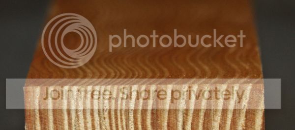

This is not a good photo but it might help to explain what is quartersawn.
When you look at the end of the board, the bands that are the growth rings of the tree will be perpendicular to the face of the board.
Quartersawn wood tends not to move as much and is desirable for guitars and other higher end projects.
If they are real heavy they may still be green so sealing the ends will help prevent cracking. Good thing is walnut is one of the more forgiving woods to dry.
Mark thats some wild grain for quatersawn :thumbup:
Thanks for all the replies, Guys. Phillip, now that I understand what quartersawn means, yes, they are quartersawn . For the time being, I'm going to check out the grain, color, etc., by cutting off a piece and finishing it. I think I'll just seal the ends as you guys suggest, and just ponder on it for awhile. I'm curious about the cherry wood too.
