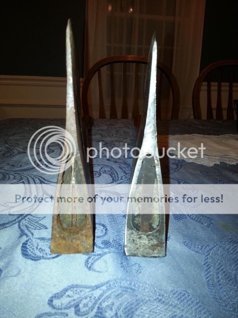

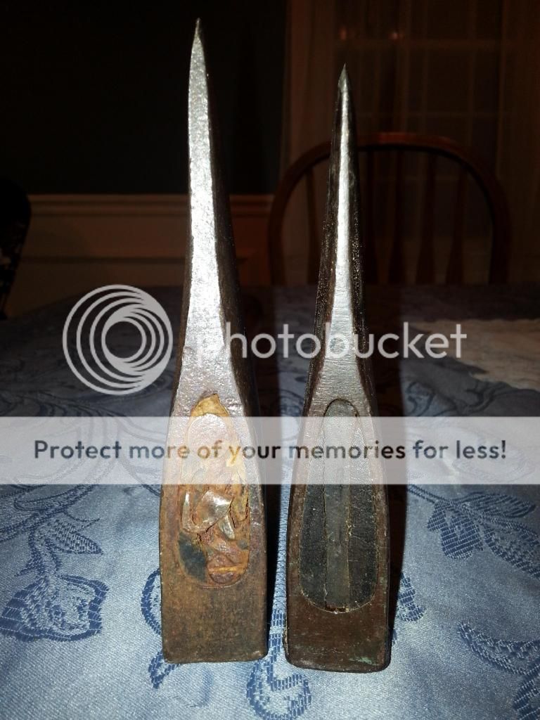

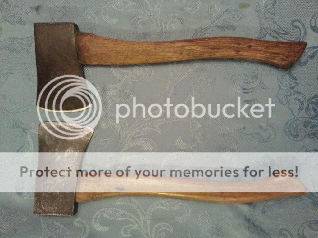

Both of these axes are very close in design. Both are the same size and condition, with a great head, great handle that needs only to be refinished and a splitting profile. This would be my firepit/camping axe.
Both have a roughly boy's axe sized head on an 18 inch handle, both cost me $5 or less. The Plumb I need to tighten the wedge but the wedge is pretty and clean. The Union has an ugly mess in the wedge but it is rock solid. The Plumb is a great old name, the Union is great because it is uncommon. I feel that both work function identically. What would you choose?

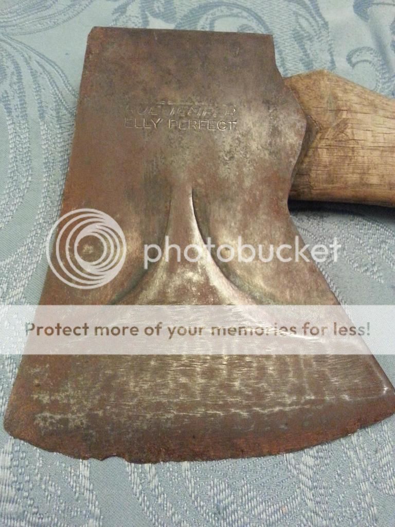

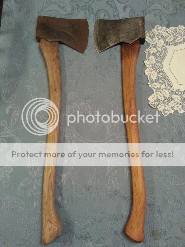

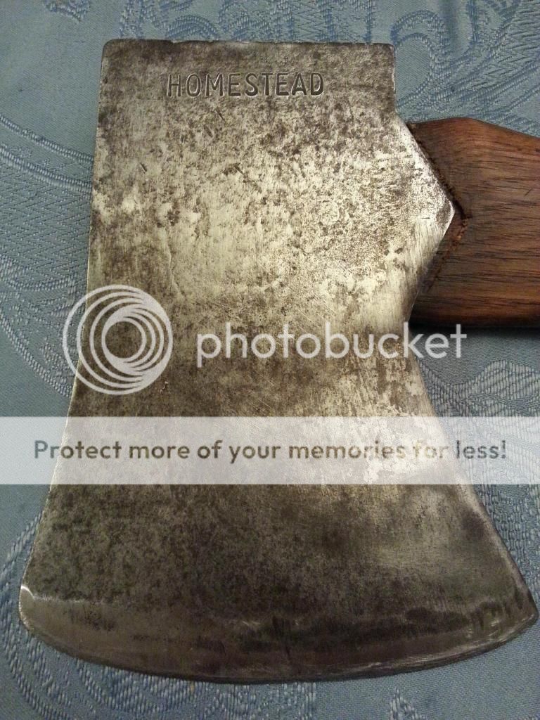

A Collins Homestead versus a True Temper Kelly Perfect. Both are the same size and profile and would serve the same purpose and be functionally equivalent. Both are profiled for cutting, with is about %5 of my axe use. I don't need these, I just love them. The Collins is one of the first that I have taken apart, refinished and rehung with a new wedge. It is done and functional. The Kelly is where the Collins was and needs all of that work done. It is tight but is not fully seated as if the person that rehung it didn't get it all the way in. The Kelly has a chip. The Collins is better right now, the Kelly could get there. The Collins looks awesome, the Kelly has the advantage of being one of the best looking(in my opinion) axes ever. What would you keep?
I really like the convex profile of the Plumb axe. Looks like it would throw some nice chips....
Hell, for $5 each, I'd keep both of them. A .50 cent metal wedge will most likely tighten up your Plumb head.

Your Kelly Perfect looks like the previous owner used a bench grinder to thin out the edge. That may be why it is chipping. He may have gotten it to hot and damaged the temper. But, that's just a guess.
Normally I would say keep and use the Kelly...because I'm just partial to Kellys. But that edge just looks like it was ground down.

1. Plumb. More useful profile.
2. Collins. Better condition head; the Kelly has been abused. And, I don't like phantom bevels; they are too much like lace on work pants. Normally it would be Kelly all the way, but I don't care for the perfects as much as I probably should...

1. Plumb due to the profile and the fact that my Plumbs have excellent steel.
2. Collins...I agree with Double Ott...that Perfect looks like it could potentially have had some major abuse.
#1 Plumb, I like their profiles and find the edge treatments consistently good on Plumbs
#2 Kelly Perfect, I like the bevels and would clean up the edge and try it out. If the edge is
compromised, it easy to replace that size axe

I guess I should have given an explanation like the others. I just got in a hurry. The Union Tools hatchet has a better profile, more bit remaining and a larger poll - i.e. better balance. The Plumb has a weak toe (worn).
A Homestead is a second shelf axe. A Perfect is a top shelf axe. The Kelly has been thinned a bit but grinder marks back there aren't damaging to the steel. If the bit has been compromised it's easy enough to file it back to good steel. But I don't think the bit has been compromised. That chip in the bit is a sign of abuse, not a bad heat treat. And the fact that it chipped instead of rolling leads me to believe that the edge wasn't over heated by a grinder. Plus the Kelly has more bit remaining. More bit of higher quality steel. No-brainer.

I'd keep the union tool works hatchet. The Plumb would probably fetch a better resale price just because of name recognition, The Union tool has a fuller fresher bit and is a less common hatchet.
I'd also go keep that Kelly Perfect, They're some of my favorites (love those bevels) and it has a neat old haft on it.
