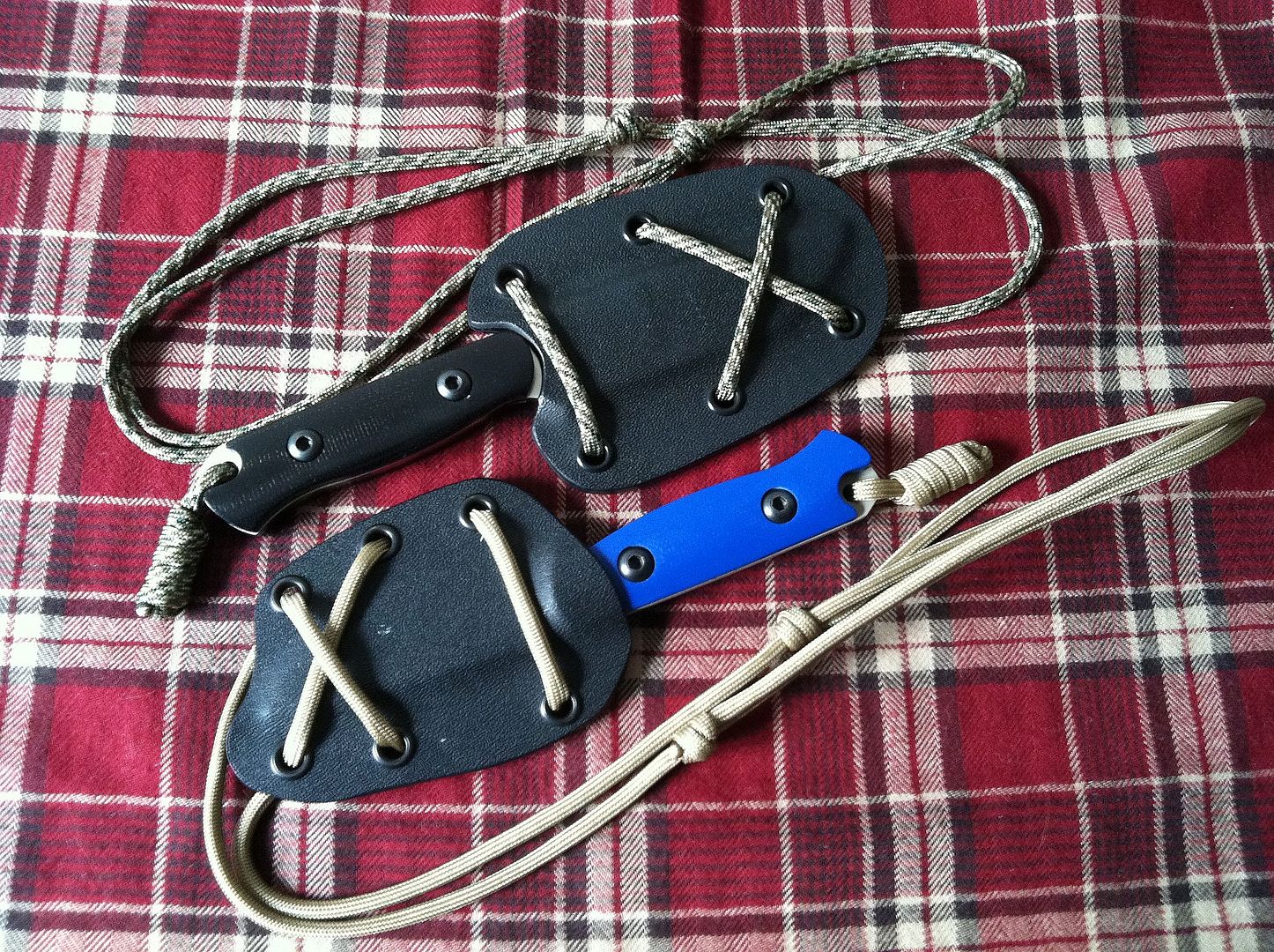

Tops Ferret. The sheath is very secure since it is considered a neck knife by the manufacturer, which means the retention is very stout and it's thick kydex.
