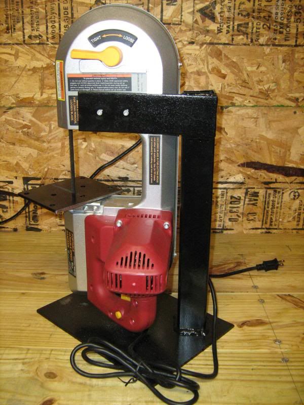

Here's how I did my Harbor Freight saw.
For the budget conscious the portable bandsaw is the way to go. There are almost as many ways to customize it as there are people with a desire to do so. My own customizations were much simpler and essentially free... but nowhere near as pretty.
In any case, as was noted before, owning a separate bandsaw for cutting handle materials would not be a bad idea. The portable bandsaw can do it, but the tendency would be to just change the speed and not the blade, which will result in a messy mix of stuff building up inside the saw. You'd probably be better off keeping them separate (though I still use one portable bandsaw for all my cutting needs).
