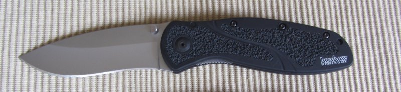

One other detail... The new Sandvik blades are all hollow ground vs. flat ground on the S30V and CPM154 blades (see this thread). All three are great steels. You will get better wear resistance with S30V and CPM154, but the Sandvik will take just as fine an edge.

Pics of the two different grinds. Top is the hollow-ground being used on the newer Blurs w/ Sandvik steel. Bottom is the flat grind used on the S30V and CPM154 Blurs.
