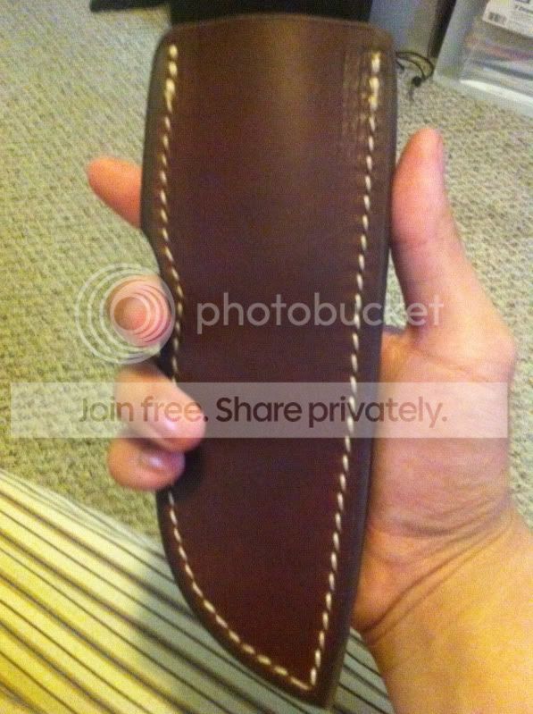

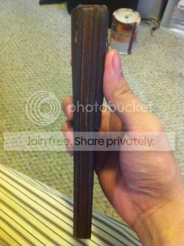

Just got it in today:
It came shaving sharp, but being OCD I wanted a little more and took it to my Worksharp:D. I started off on the 150MX belt, then 240MX, 400MX, 600MX, 12000, and finished on my Mother's Mag Polish loaded belt. The resulting edge was able to cut my hair clean through without splitting it, though I normally have to cut close to where I'm holding it in order for it to bite. Though that edge quickly dulled after cutting some paper, it still pops my leg hairs off. Seems to like long slicing cuts rather than push cuts, which made me wish I had asked for a longer blade(about 3.75" now).
Sheath is a little thick at 5/8" at the thinnest part, and a little over 3/4" at the top with the belt loop. On the bright side, I won't have to worry about the edge cutting through the leather accidentally:thumbup:.
I'll go buy some apples to test how it slices and dice up some postal cardboard to test the edge retention.
