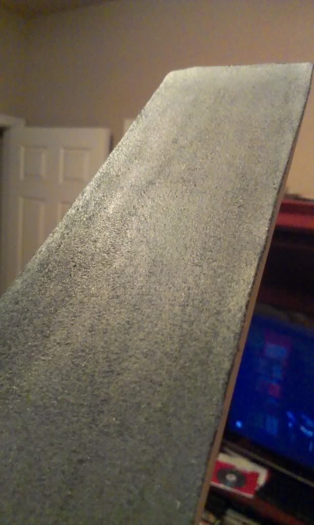

Op I hope you don't mind me butting in. I just wanted to say that I'm glad that I read this thread. I used the Crayon type stick to treat my new strop and it was fairly chunky. The idea of using a paper towel never crossed my mind, but it also spurred me on to waving the strop slowly over the stove. Not getting it hot, but just enough to evenly distribute the polish. It worked quite nicely indeed. I'll try to post a pic in a few. :)
Edit- eh... not the best pic but its pretty even. The nap will lay evenly when you brush your hand across it. The leather was black.
Okay, I'm done interrupting.
