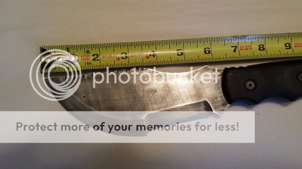

What the Heck is this? Patina? Finish on 1095 Tops Tom Brown Tracker
Looks Like a Tom Brown Tracker With a Stripped Finish, Then Patina, Looks Fairly Dark, Perhaps an Acid Etch Patina
You Would;
Strip The Paint With Paint Stripper, (This Does Not Damage The Blade, Or Edge)
Then...
Use It ALot,
Or Give It A Quick Vinegar Bath,
This Is a Mora of Sweden With A Mustard Patina, (Sorry If The Image Messes Up, Im New at Posting)
Thank You very Much. How would you get the lines in the blade? They look like they are etched in the blade?
That is beautiful !! How difficult is it to make a mustard patina? And does it last on the blade with rigorous use?
I Have Made Many Patinas, The Trick Is To Have a Base Patina, So Everything Else Darkens More,
Wipe The blade With Vinegar in A Paper Towel,
Then Make THIN Lines for DARK Lines
and THICK for LIGHT Lines, The Less Oxygen That Contacts The Steel, The Less Dark It Is.
It Holds Up Very Well, The Bevel Patina is Gone Now Due To Stropping Thogh
Its Relatively Easy
