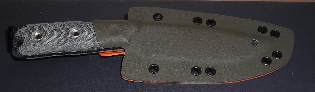

I like the .093 even for small knives, It warps less in the press for me.
Some colors only come in .08 from knife kits, now I am matching them to .093 backs.
Very cool idea there Steelnut! I like the orange back.... it's almost like a reversible hunting jacket... :cool:
