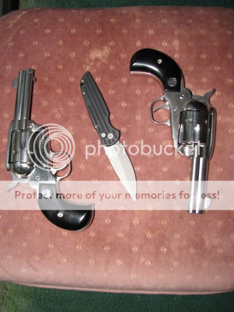

Chris Pierce, here are my .45 Colt Birdsheads;
