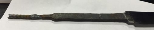

I'm not going to lie, this was an impulse buy from my iPhone while I was at a bar many months ago. It finally arrives a few days ago. The hilt and scabbard are wood but very cheaply made. However, the blade is a very nice and thick piece of carbon steel. It's shaped like a Japanese tanto. Quite sharp too. It's sloppily made by nihonto standards but by "cheap handmade knife" standards it's quite good. The auction description says it was edge hardened but I haven't tried to etch it yet.
I pulled the cap off the pommel and found a nut screwing the tang into the hilt. I removed the nut and disassembled the whole thing. The tang is actually quite wide and almost the entire length of the hilt. It's wide enough to put pins through. They welded a small threaded piece of metal to the end so they could assemble the thing cheaply.
So I'm thinking saw off the threaded part, drill a hole or two in the tang and mount it with a proper handle. The tang isn't wide enough to put scales on, but it's wide enough you could run some pins through it. The current handle is mostly hollow so it wouldn't be suitable for hard work, and the thing is too tacky looking to be a decoration piece
Any suggestions?

I dunno. Sarge used make Po-boy knives out of files where he drilled out and epoxied the tangs into the wood. Maybe a stepped down hole for the tang? Bore out one for the rod as it's not hurting being on there then counter bore out a larger one for the fatter part of the tang. Epoxy it in and maybe set some pins through the wide part of the tang for peace of mind?
I think I might be able to get away with just filling the hilt with epoxy and leaving the rest as-is. Between the epoxy and the nut screwed into the end of the tang, I don't think the blade would fly out of the hilt unless the hilt split in half length wise. Even if the epoxy comes loose you'd still have the nut keeping the blade from flying off at least temporarily.
The auction description said the blade was clay tempered but I haven't been able to produce a hamon. I'd be very surprised if it was considering what it cost but I figured I'd check anyways. I chopped at some wood with it and it actually cuts pretty good. It'd cut better if the edge profile wasn't so thick. I wasn't too tough on the thing considering how I have no confidence in that hilt, but I checked the edge when I was done and it didn't chip or roll. Now I'm thinking about mounting it like a Japanese hunting knife. Like I said the blade isn't ideally shaped for that use but I think it'd do an okay job as a camp knife.

i'd fill the handle with epoxy & skip the pins, & reassemble. with that length/width of tang it's not going anywhere. the nut on the end is just gravy & all it need to do is hold everything together while the resin cures. most scandinavia knives as well as khukuris have shorter tangs than that held in with resin and last under extreme use. refinish the wood as suits you.
i use a high strength titanium filled epoxy, or std. epoxy mixed with chopped & shredded paracord to improve the tensile strength.

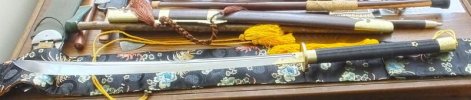

i bought a midrange miao dao sword from zhiswords, a couple years back, they communicated well, was not in stock and had to be 'custom' made and tho it took a while longer than expected, it eventually arrived in a sturdy silk covered light wood box with a silk sword bag, box was filled with a block of cheap foam cut to fit the sword & covered in silk. blade is nice pattern welded, fullered, & sharp as heck, decent polish. grip is solid, well wrapped in the chinese style with about 1mm cord, full length tang pinned near the end with a hollow brass tube with ends rolled back over flower petal shaped keepers, cheap-assed brass acorn nut on the end with a hole for a tassle is a bit tacky, but otherwise nice. nice thick brass chinese guard. engraving is fairly shallow & scabbard fittings thin sheet metal, not cast with deep patterns. the owner or manager contacted me a number of times in good english. he advertised on etsy for a while too. he also makes some cheap swords that look a bit tacky. caveat emptor. ive since added a proper chinese sash hook, braided up a new suspension and moved put a tassled lanyard thru the grip rather than the acorn nut. (which i'd replace if i could find a decent replacement.)
i've heard a number of the chinese sword makers are suffering from the current recession and are going under...
miao dao
tarted up a bit now
