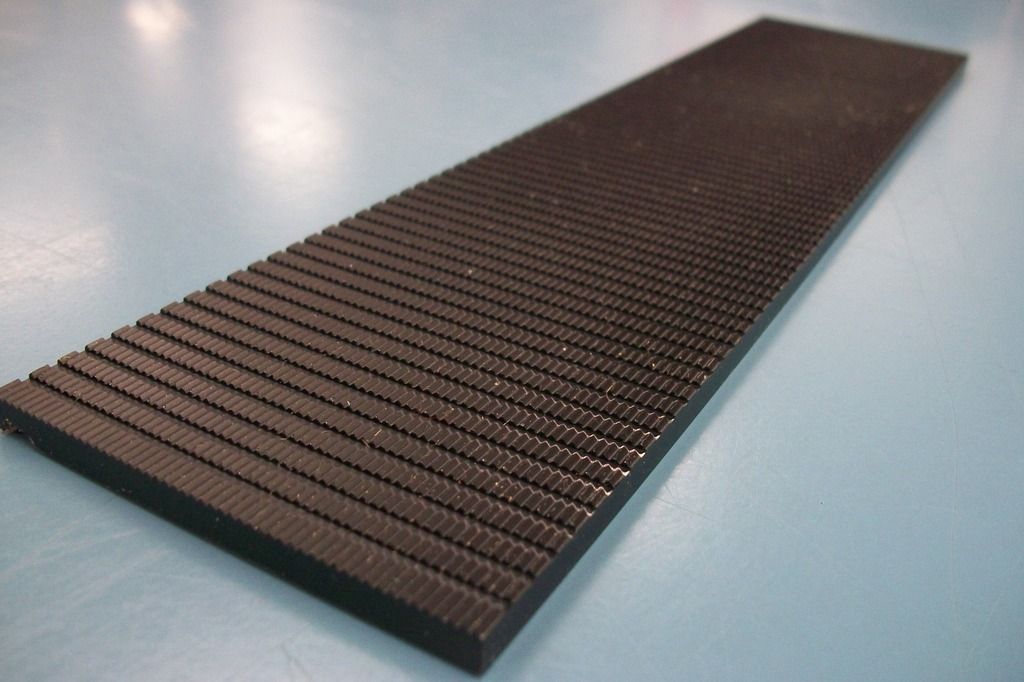

I have knives that have not seen a stone for a loong time, maintained only on a Washboard strop. I use mine most often like a hybrid polishing grade waterstone. A single sheet of paper over the top and it produces essentially zero rounding. If you want a softer/brighter finish just use two or three sheets of paper and progressively finer compound.
