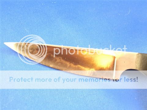

I saw the other thread about Hamon, but did not want to hijack it. So here is my question. What Are you supposed to look for in a GOOD Hamon?
I was finishing up a blade and had clay coated and quenched, sanded pretty well, then etched with lemon Juice (I haerd that will make the hamon white and that is what i wanted) and polished it with Mother's Mag polish. It was looking good with some fire like glistenings at the top of it. But oit wasn't as white as i wanted so i etched and polished some more, tying to get it whiter. Well it got whiter, but the fire went away and the hamon started looking like a satin finish almost with no transition type of line from the hard to the softer metal. Which is not what i wanted, but is that what others look for?

In my opinion a good hammon reveals the true nature of the heat treat and the grain structure of the steel as it was developed.
In my way of thinking ( and what I have learned from reading texts on Japanese sword smithing) A hamon that is a bright,sharp line is not the nicest.It should be a subtle thing,with wisps and ghosts.The true hamon is seen at an angle of about 30 degrees in reflected light.Many hamons will not show well until properly polished,which can be a daunting task,and is never quickly done.As Ed Fowler stated,the hamon shows the different steel structures and how they formed.If all you wanted was a bright line,you could mask off the blade and etch one in (like those fake Chinese swords).

I've wonderd the same about a hamon. I usually sand mine up to about 1200grit, then etch in warm cider vinegar--after that I polish with flitz and a paper towel for about 30min.
I will say this, taking a pic of the sucker sure is difficult:(

Thanks guys. I really like one like in SSheapard's picture, and that was sort of the way mine was when i first etched and polished it, unfortuanately after more etching and polishing that thin transition line from the hardened to the softer that shows up in his pic, doesnt seem to be on mine any more, now mine is a definate whiter but more satiny harder part and then the shinier softer part, but no transition area. I tried taking a couple pics of it today, but couldnt get a good one to show. So i will probably try resanding it and starting over. :(
wow !:) Thanks guys, I might have actually done 2 things "well" this month:o
Any tips on how to take better pics of the beastie?
I tried a light backgroung in a lightbox:
This way it just didn't come out as well.
