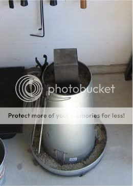

im sorry if this is either out of place or duplicate, i searched quick but this place is so huge i didnt cross anyhitng. for all you knife, hawk, sword makers, what can be used to pound on instead of an anvil. where i live its damn near impossible to find one, and i cant afford to have on delivered. i also here some guys use rail line, i dont have acess to that either.
id like to start with a few simple knives from stuff i have around the garage (files rasps ect) and advice?
Well you can use almost any large mass of solid steel. I have heard of people using 4" square stock by about 12" long stood on end in a bucket of sand. Make sure it is steel and not iron, but if you are just scrounging then I guess it doesn't matter much. Mind you I don't forge stee myself, but have a great interest in it and am just passing on what I have read, and if anyone sees fault in my answer, please correct me.

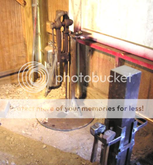

I have two "real" anvils, a Mousehole and a Hay Budden, but this is my favorite knife making anvil.
It is a 5"x5"x25" piece of 4140 that weighs 208#. I found it at my local steel scrap yard. A good friend found a 5x5 drop at a local machine shop ,that weighs 180#, for 50 cents a pound about a month ago. Don't be afraid to ask around.

Ibeam pieces, fork lift tines, bucket pieces from dozers, just about any large, dense piece of steel. If you set it in concrete or sand with the main mass below the part you are pounding on, you should have a fair anvil. Think cutting off a fork lift tine and driving the point into the ground and using the cut off part as your anvil. From what I understand, it's all about the mass under the table that makes a good "anvil".

A dry wall bucket, a sack of Quickrete, and a good size chunk of steel....will work as a starter anvil.
