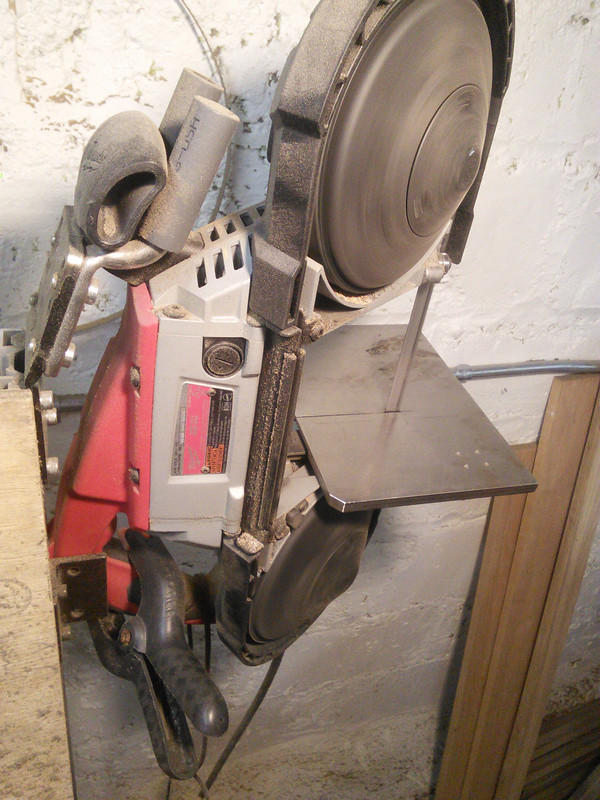

*I absolutely agree with the portaband saw. Love it!!! I wish I bought one ages ago. I made my base/table for it though. My fil has the swag one. I still need the foot-switch. I use a hand clamp.

metal band saw (SWAG table and a used Milwaukee Porta-band is a great combo).

On my porta band I use a zip tie on the trigger and have it plugged into a light bar. Its the only thing on the light bar so I use the switch on the light bar for on and off. Has worked very well for me and the way I work probably better than the foot switch.
I imagine your way is cleaner not having debris falling on a foot pedal, not to mention dealing with moving it around and tripping on it.......
And a little more professional looking compared to my "switch".
