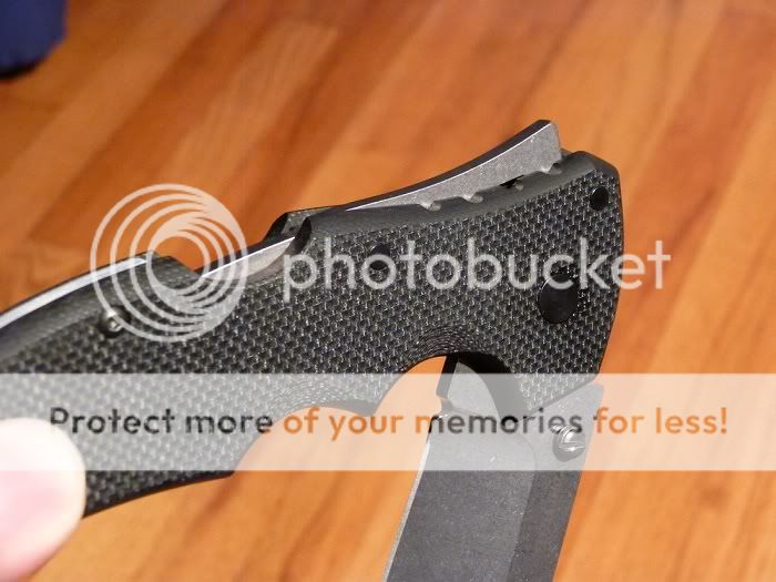

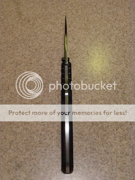

What is the least caustic stripper I can use to get the teflon coating off? Will acetone or denatured alcohol work? Thanks.

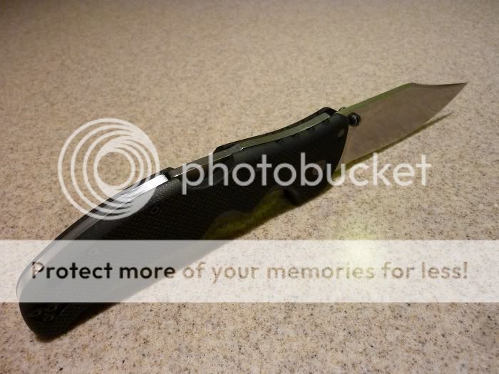

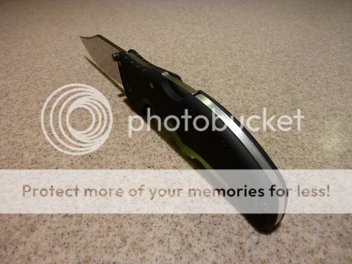

Nice work. For posterity, and future searchers, I used Jasco epoxy stripper and it had almost no impact on the finish. I left it on for a long time, and cleaned and refreshed it at least a half dozen times. Eventually it knocked off a few flakes. I gave up and began manually removing the remaining teflon using a piece of plastic as a scraper. Took two days worth of messing with it. I am happy with the results but what a pain in the butt. I will never do it again. :grumpy:
Brake fluid works a treat on most coatings without destroying the surface finish of the metal. Be careful around the handle though.
Teflon is very chemically inert; in fact it is so inert, it is used as the lining of scientific chemistry pumps which pump caustic stuff like acids. I don't think it will be easy at all to find some chemical that can strip it off.
Teflon is used as a knife coating not only because it's slippery, but also because it's super resistant to corrosives/chemicals!
