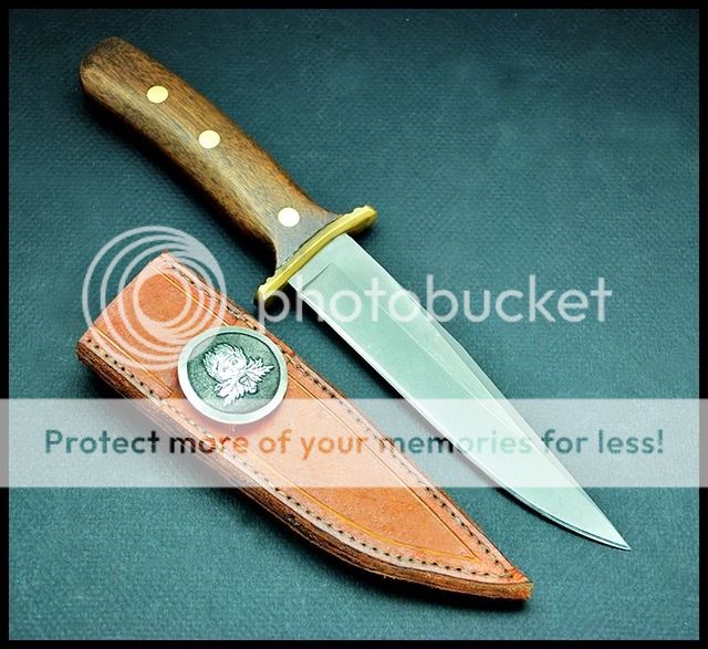

A friend once told me he was going to try his hand at making a knife. Never heard much about it after his initial announcement. Then, a couple of months later, he tells me that the project has him totally frustrated and he hands over his first effort in all it's unfinished glory: a Night Hawk blade with a steel oval handguard and a roughly shaped wood handle.
I took it all a part and started over. Had the blade beadblasted, filed out a guard and epoxied and pinned on a walnut handle. I sewed up a sheath and scratched up a concho for it. All-in-all, I think it worked out ok. :D You can't beat free stuff and it sure does look good on my CAS pistol belt:

Wow! If you showed me that knife without mentioning what you had done to it, I never would have guessed that it was a re-done Nighthawk. And I have one myself.
Great job.
Poco, that is awesome!! You did a fantastic job.
By any chance, did you take a pic of the tang before you put the wood handle on? I'd like to maybe rehandle mine, but I want to know what to expect.

No, I sure didn't take a picture. I probably should have but I was under the influence of a spontaneous and fickle muse and had to strike while the iron was still hot as it were.
I do remember that it was a long, narrow, full tang and that it had an odd number of holes for cross pins. Not sure if this was the result of my buddy's drilll press work or if they were original. I inlet the tang into both scales and then drilled them for the few hidden cutlery bolts I was able to dig up in the shop. Hence the odd number in the new handle. I figured the more reinforcement the better.
Hope this helps and thanks for the feed back.
