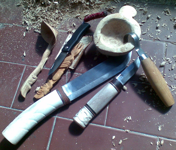

IMO, a good sharp knife (scandi grinds excel at this IMO) and a decent spoon/crooked knife can accomplish just about anything you need when it comes to carving. If you want to speed things along, a nice sharp hatchet does wonders :thumbup:
What Killa Concept said. Use a saw to get it to the length you want, a good sharp knife (scandi's excel here) to get your shape, and a crooked knife to get the bowl shape. If you use coals to burn out the center along with the crooked knife will speed things up considerably.

For a carving knife you'll want something with a very comfortable handle that works in many, many grips first off. The blade shouldn't be overly long, 3-4 inches is *plenty*. Scandi ground blades do excel at wood carving--I actually bought a Mora for this purpose, and that's nearly all I use it for. Any knife with a good edge will work well for carving, but the scandi does bite better, which makes things go a bit faster especially when carving across the grain.
For carving out the bowl get a hook knife. You *could* also try burning it out. A Mora hook knife is something like 10 or 15 bucks shipped and is very much worth the investment.

coffee mug: Burn the center out of the wood you are working on with coals from your fire, scrape out the carbon/charcoal with what ever knife you have and repeat till you reach the depth you desire.
A little work and Voila a Wooden Coffee Mug.
