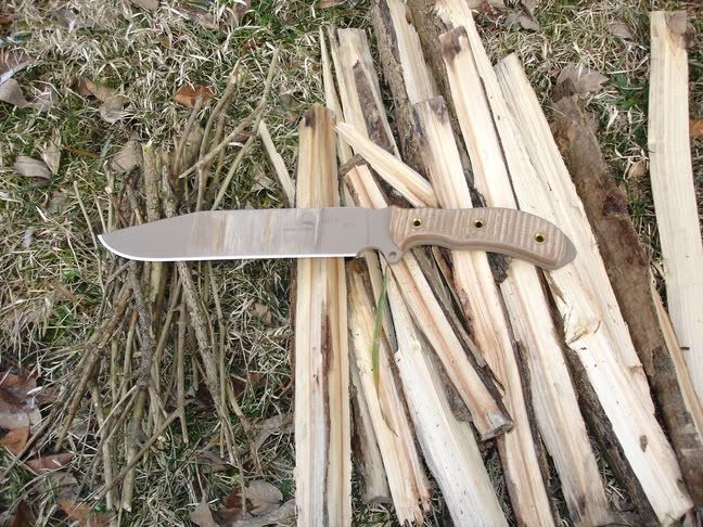

I'll start off with what I like. Handle lenght of 5 to 6 inches. Blade length of 71/2 inches or longer. Blade width of 1 1/2 to 1 3/4 inches. Steel, 5160 being first choice. Other steels would be oil hardening straight carbon steels. Handle material, micarta or kraton. Also what type of grind. I think the convex is best suited for this.
The pic below is one of a 5160 Busse blank I purchased from and had Justin Gingrich heat treat for me to 58rc. in action. I've chopped down large saplings, split seasoned maple (as shown in pic) cut water filled soda cans and cut the front legs off of deer. I feel 5160 steel IMO is the best.

Here's a pic of my favorite knife for spliting and chopping. I've had a ball using it while hiking and bumming around in the woods. It's the one I mentioned in my first post.

Dr. Thor:
you keep showing off that gosh-darned bm-e of yours! LOL!! First with ham, now wood! I think that's the one Jody (voracious) had recently for sale on the exchange forums. I was SO CLOSE to getting it, and when I made up my mind, it was gone. Lucky you!
