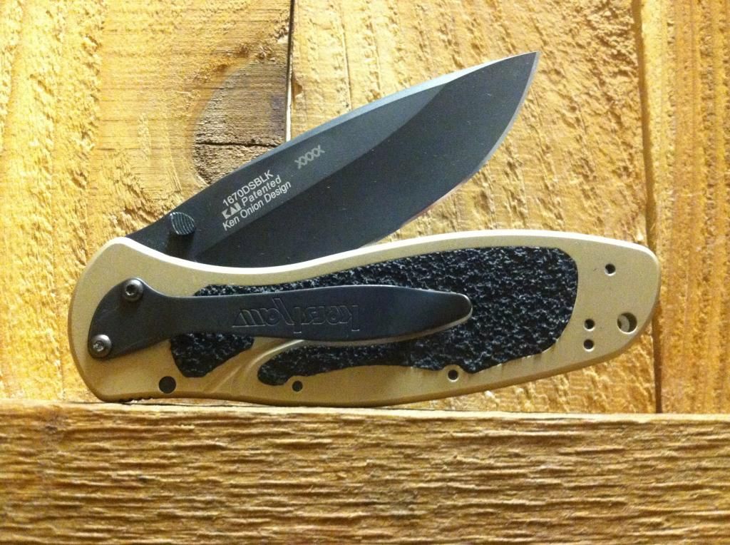

What does everyone think about the Dessert sand Kershaw blur? I have on and love it exept for one thing... The fact that the pivot screw come loose after opening about 2 times... which makes the alignment go wonky... What would fix this? I always carry a torx bit that is the correct size in my leatherman case (on my person) but I wonder if a little red Loctite will help? Or will if freeze up the blade?
Thanks- Bergermiester:thumbup:
i would use blue also. alternatively, i've heard you can use thread seal tape like what you would use on water pipes in your home.
Ok I will try it thanks! Why the blue instead of the red? I do a lot of work on cars and moving machines, we always use red becasue it is stronger.
Red requires heat and a good amount of torque to remove. Not necessarily permanent but you may damage the screw/knife if you ever want to disassemble it again.
Ah ok thanks, yea i didnt even think of messing up the screw... i use red loctite on all projects and fixes that i do on cars and i am usually using a ratchet or cheeter bar to get them off... I hope that wont be the case here... I will use blue, thank all yall
