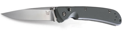

Some examples from a broad range of designs -
