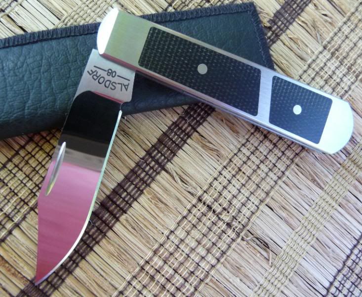

Mike Alsdorf makes Interframes as well.
Yes, he does :cool:
