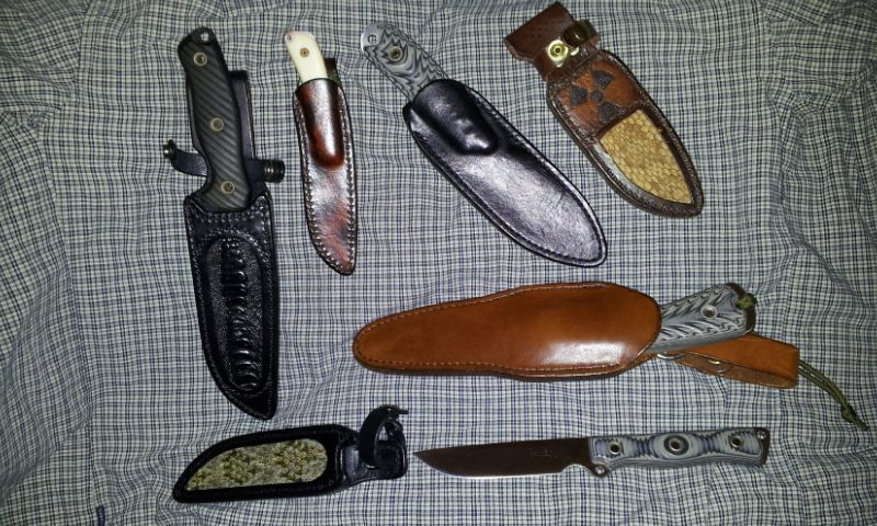

I have quite a few of your sheaths and I have both types of stitching. I remember requesting hand stitching for one so I think that is where my bias lies. ;)
That said - I am 100% happy with the machine stitching you do as well. I have never found a fault and the machine gives a consistency that is hard to replicate. Looks good in close up pics, too. That is one of the reasons I lean ever so gently towards hand stitching - they give the sheath a unique, hand-made look that is kind of - for want of a better word - rustic.
I grabbed a few sheaths of your s and took a pic - just by looking a person can tell which is which. Pardon me for sticking and RMD into an RMDxLE sheath - I kind of rushed it !
All that being said - I am happy with the Machine and would only be asking for hand stitching for those "special" projects.
Hope the pic is good enough to tell:
