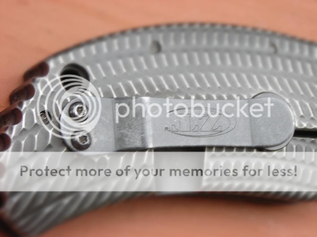

Wait for the 0300BW!
I like mine more than my 0301!
River rock in a peanut butter with a few oz. of water. Wrapped in a towel and but in the drier for 25 mins. I put a few old towels in the drier too. I used good size rocks 1 1/2" to 2" mostly but also used a few 1/2" ones. I did the blade and ti lock side separately just to be safe.
Mind elaborating?
Please :)
This may be a dumb question but how full was the jar of rocks. Was it as full as you could get it and still fit the blade or was there plenty of room in there?
Only about 1/2" full of rocks. The rocks need room to move to do their job.
The edge was quite beat up and dull.
