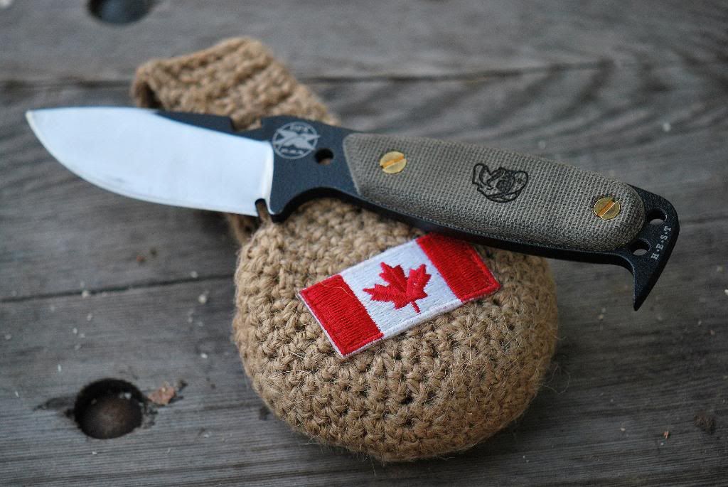

100% - I don't use chemical stripper, because I don't like using chemicals. Also, I don't want to remove the coating under the scales or elsewhere, that doesn't get actively involved in the cut, for protection. I affix a piece of sandpaper to a board, lay the flats on the sandpaper and work it back and forth, while watching the tube. That's how I did my H.E.S.T. and RC-3.

Looky thar. That sucker is so sharp it took his Canadian scrotum clean off!
