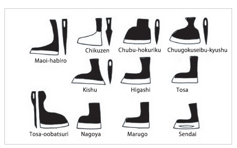

This is Japanese, a carving axe and for carpentry, woodworking broadly, so not used primarily to split your firewood though in a pinch I guess you could do that. It looks like it may be laminated with three pieces rather than having an in-set edge steel, both techniques used in forging these axes. These are handled with Japanese White oak and the handles are shouldered then tapered, swelling towards the bottom end slightly. An iron wedge is used set near the front or back edge at a right angle to the length of the eye and left protruding so it can be hammered further in if the head loosens. It's standard that the heads are bulky like that. So the deal is, it's a nice axe, very nice.

That chart is great! I've tried online sources to translate the kanji, but no luck yet. I'm really no liking the "traditional" way they attach these to the handles, with the metal wedge sideways and sticking out, so I'm just going to handle it "American" style. I wonder if my exotic hardwood store could find some Japanese white oak...
