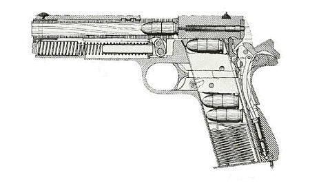

Single action in, well, action.
this one is a bit slower, and illustrates the hammer and pin nicely.
The hammer drives the pin forward sharply into the primer, the little cap set into the bottom of the brass cartridge. This goes off (I used to set offprimers in empty brass by setting the brass on a dart in the garage wall, and popping it with a bb gun. Til mom caught me.), and travels through a little hole in the brass to the actual powder charge in the brass.
With a single action, basically you pull the slide back, which cocks the hammer. When the slide goes back forward, it strips a round from the top of the magazine and snugs it into the chamber. Pulling the trigger releases the hammer, which slaps into the firing pin. Recoil drives the slide back to start the cycle over. The trigger is reset, and it takes just a very light pull to drop the hammer each time.

aaaahh...that was a superb diagram!!!
Now i understand.
Let me clarify though. Correct me if i'm wrong.
For SA, you pull the hammer back and when you pull the trigger the hammer hits the firing pin. To cock the gun, you either pull the hammer (if there's already a round in the chamber?) or you pull the slider back which loads the round as well as cock the hammer?
For DA, the trigger pull actually pulls the hammer back and cocks it automatically just before you fire. So the hammer is never permanently in the cocked position?
