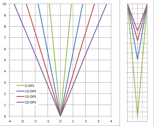

This utility razor blade pictured here has ~10dps edge/0.017in(431.8micron), increase that to 15-25dps and try cutting up that same chicken bone, (all the other pictured knives all sharpened to 30-inclusive)![]()
When Joe Calton mentions 0.020" thick for chopping bone, that is roughly comparable to the green blade in the diagram above. 0.020"
Compare to this image that howto measure angles thickness with calipers

So the way I think about edge angles and thickness,
compare your edges with your fingers/eyes to utility knife razor blade
don't need to know actual thickness numbers of your edge,
if your utility knife blades dont say how thick its easy to measure with simple centimeter/mm ruler, then compare to this list, and decide go up or go down
- 4 to 6 dps (8-12 inclusive) -<0.005", light use knives, paper and cardboard, light ropes, knot free woods
- 8 to 10 dps (16-20 inclusive) -<0.005"-0.015", moder push cuts on woods, thicker plastic, heavy ropes
- 12 to 14 dps (22-28 inclusive) -<0.015"-0.025", hard push cuts on very knotty woods, bones, etc.
- 12 to 14 dps (22-28 inclusive) ->0.025" dps, chopping blades
- 0.025"/15 dps (30 inclusive) = 0.635 millimeters / 15 dps edge overbuilt , cutting into or contacting against very hard materials like rock, metals and such. It is over built for cutting but well built for durability in extremes/utility.
- 0.025"/15 dps (30 inclusive) = 0.635 millimeters / 15 dps edge overbuilt , you could chisel cut through nails and such without issues , $1 one dollar knives or $5
- 0.035"/20 dps (40 inclusive) = 0.889 mm 20 dps beyond overbuilt , $1 one dollar knives or $5
- 0.045"/25 dps (50 inclusive) = 1.143 millimeters /25 dps sillybuilt
- 25 dps and 30dps (50-60 inclusive) and higher are angles for metal cutting cold chisels or splitting wedges or a table knife
