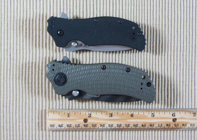

I've been thinking about buying my first ZT. And when I think of ZT I think of that thall, fat belly blade. So I've been looking at the 0350 and 0300 series. Only trouble is they look so similar, and the blades are made of the same S30v. So why the $165.00 difference???
0300 is larger, has 3-D machined scales (G10 front, titanium back), and is a framelock vs. the 0350, which is smaller, has flat textured G10 scales on both sides, and is a liner lock. If you prefer the size of the 0350 and want to try out a fancier blade steel, they also make a dealer-exclusive variation in M390.
The 0300 is a full titanium frame lock knife with 3d milling and is a tank of a knife.
The 0350 is smaller and is a steel liner lock with G10 overlays. The 0300 also has a solid 1/8" thick pivot screw and the 0350 uses a standard hollow pivot.

The 0350 is small for my hand and my hand isn't particularly large. The handle isn't comfortable for me but ymmv. You might try to hold both if possible to see which fits your hand.
