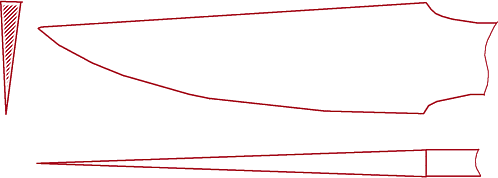

Also, in Russia, we refer to this kind of blade as a tripple wedge.
*Following is Google translation* of
http://iskonno.ru/knife/glossary.php?word=254
The triple wedge is the concept of an "ideal" knife blade, according to which all three geometric projections of the blade should strive for a triangle: "a wedge in profile, a wedge in section, a wedge on the butt" (3rd one meaning spine)
