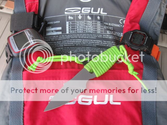

My ti MPU is used for a minimalistic kayak and skinning knife.
For kayaking its great as I go kayaking a lot and even with religious rinsing and cleaning/oiling every 'stainless' steel knife has developed rust spots.
The MPU simply sits in my kayaking rig and gets rinsed with fresh water after each trip on the water. It works great for that.
