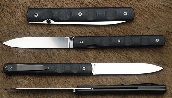

Talonite works best for specific applications. It makes a terrible camp knife but a wonderful skinning knife. Brad Zinker makes a wonderful folding fruit knife. The blade is .063 Talonite, the liners are titanium and the scales are carbon fiber. He said he sells them to citrus orchard owners and workers. This is a perfect application for the material. Citrus fruits are acidic and will rust steel bladed knives if they are not maintained. A Talonite fruit knife never rusts. It holds an edge for a long time. The people who buy them are happy with the performance. I bought my fruit knife from BladeArt. Brad also makes S30V fruit knives.
