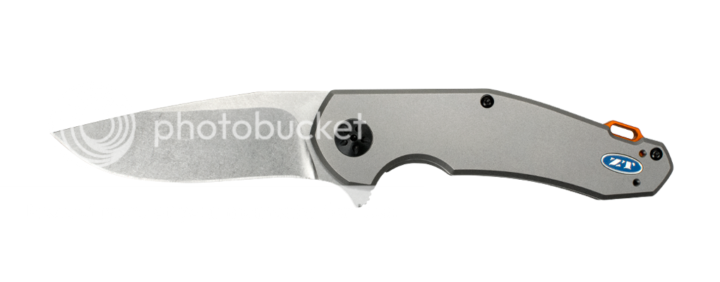

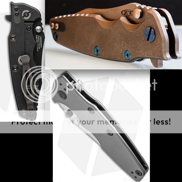

There are some knife models that have jimping on the opposite side of the flipper tab, not the (front) side your finger makes (the most) contact with to flip (lightswitch) the knife open. These knives can't (practically speaking) be opened better via pushbuttoning from the top or backside of the flipper tab, so that can't be the logic. Does anyone know why this is done? I'm posting pics showing jimping in this (what seems to be) illogical location: the Kershaw Shield and the ZT0392. I'm sure there are others. If there's a good reason and anyone knows it, please share. There MUST be one, right?.:confused:

And the jimping on the Hinderers is not useless...just the opposite. It shows where you should put your finger and push....on the Hinderers you are actually pushing slightly forward to build pressure then the jimping gives you grip to flip down suddenly. The way to build force is to push directly in line with the pivot so there is no rotation, until you give it that rotation by pulling down. Look at the relationship between the tab and the pivot center and you will see the jimping lines with the pivot center. If you begin a Hinderer flip with any downward force, it will start the rotation immediately, breaking the detent (which is on the weaker side) before enough force is built to carry the blade into lock up.
In the photo of the 0392 you will see how the entire tab is below the pivot center. Draw a line from pivot center to middle of jimping and you'll see that's how to push to do initial potential energy build.

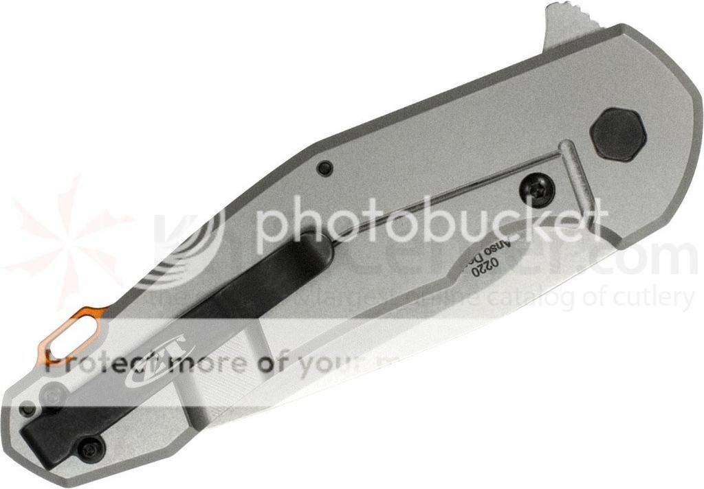

On the 0220 you will notice the tab is totally centered on the pivot.
