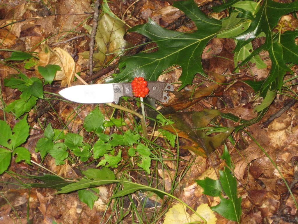

52100 on an older marble. I do have a newer Phil Wilson S110V that would do really well skinning but I'd probably want something else to pop the joints just to be safe. The S110V would take a lot to dull it.
