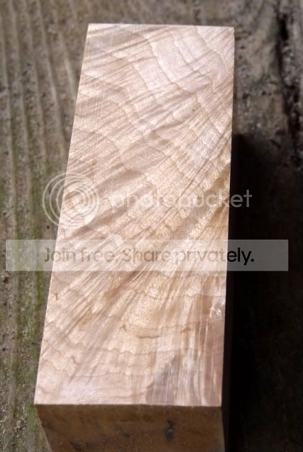

I just bought a large flat rate box of figured Hard Maple.I am wondering about the best way to finish it out.How does Aqua Fortis work on this type figure? Anything else you like better?
Here is an example.I've got 21 blocks about like this.
