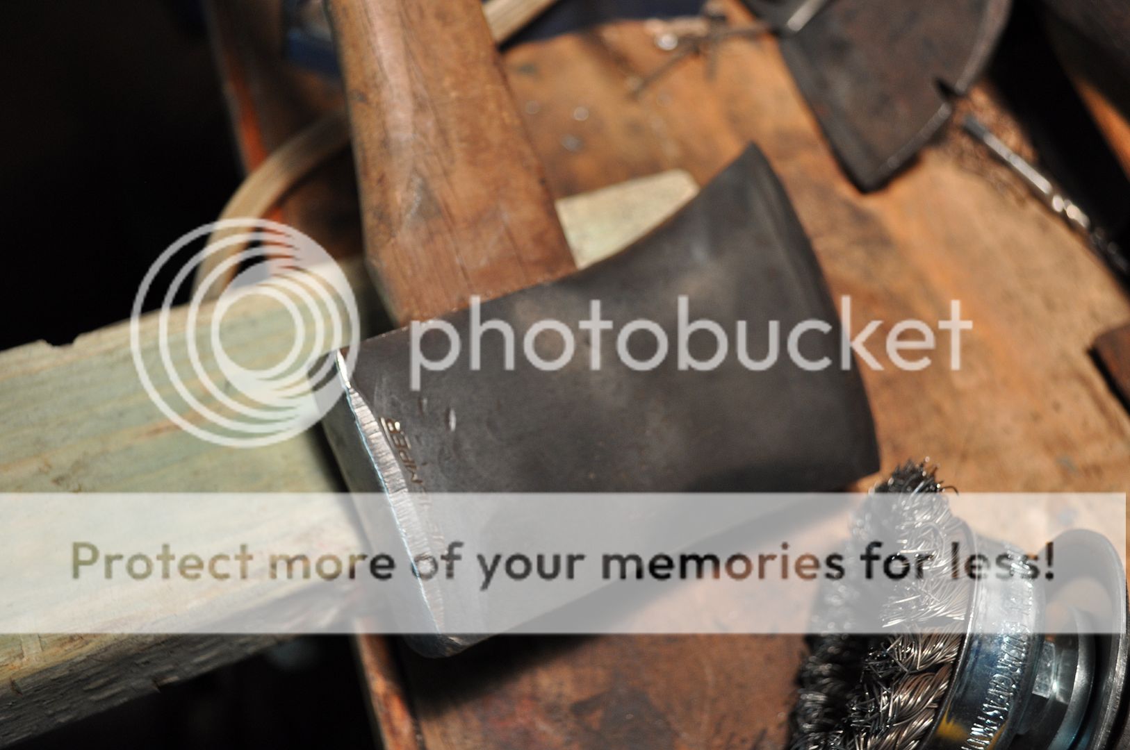

I used an angle grinder with a course twisted wire cup on it to clean up this Kelly hatchet. It was a $5 garage sale find. The angle grinder set up works very nicely and leaved a nice patina on the steel.
[URL="
[URL="
[URL="
Sharpen as needed and some BLO on the helve.
