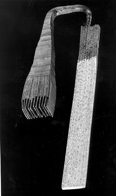

Most of what we call "damascus" today is actually pattern welded steel, another technique that has been around. Many viking swords are pattern welded and considered by some to be the height of the craft.
Real Wootz blade.
Pattern welded steel, aka what we call damascus today. (Not historical Damascus, Wootz or Bulat steel, note how the layers are stacked, welded together and twisted )
Advanced "mosaic damascus" (actually pattern welded)
