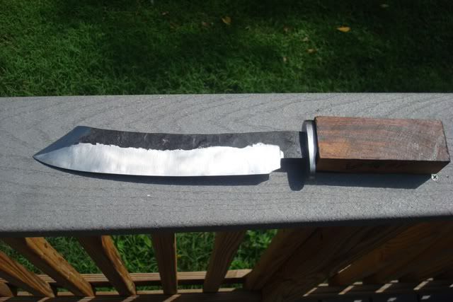

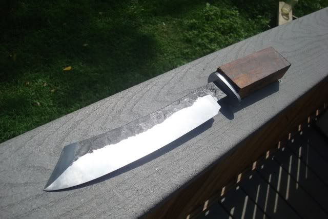

I'm working on a bowie, and now that I have the guard and handle block fitted I can't decide if I should glue the handle and guard before shaping, or after shaping?
When do you guys usually glue up something like this?
Probably some important information - I am considering (haven't become sure yet) bluing the guard. And the handle wood is Desert Ironwood.
Sorry bout the pics, they aren't very good.

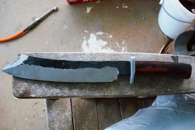

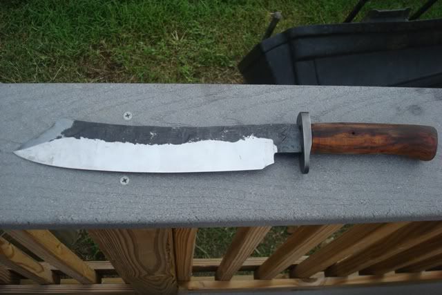

Thanks for all the thoughts guys. I went ahead and just shaped the guard and handle without glueup. Here is where I'm at now.

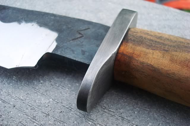

A peak at the ironwood, (it's only at 120, and just wetted to show how it'll look when oiled)
I went ahead and test blued the guard (obviously after the pics were taken). It's only at 120, and I still have to finish sand it, so if I decide not to do it, I can still opt out of bluing it. We'll see, I'll email the customer tomorrow with some pics and ask what he wants.
Here it is with the guard blued. Still have to find out how the customer wants it, and do all the finish sanding, on the knife and the handle. I'm thinking the handle might need a bit of shaping still... Go slow or mess it up.
Thanks for all the help guys, Stephen.
