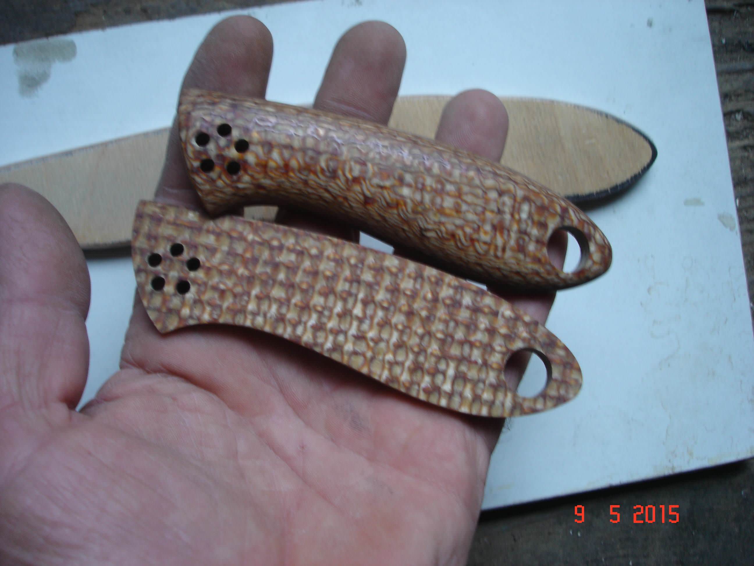

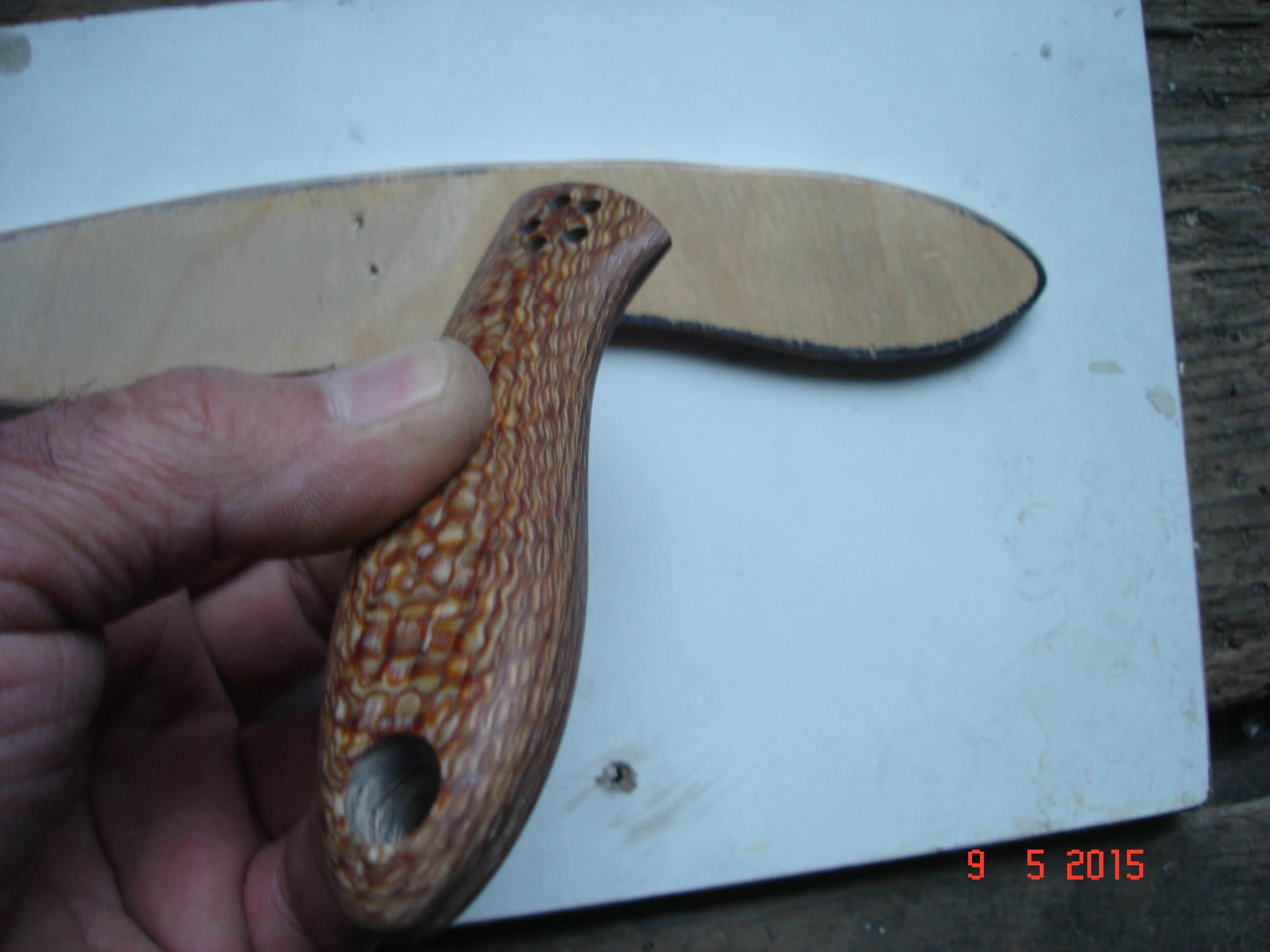

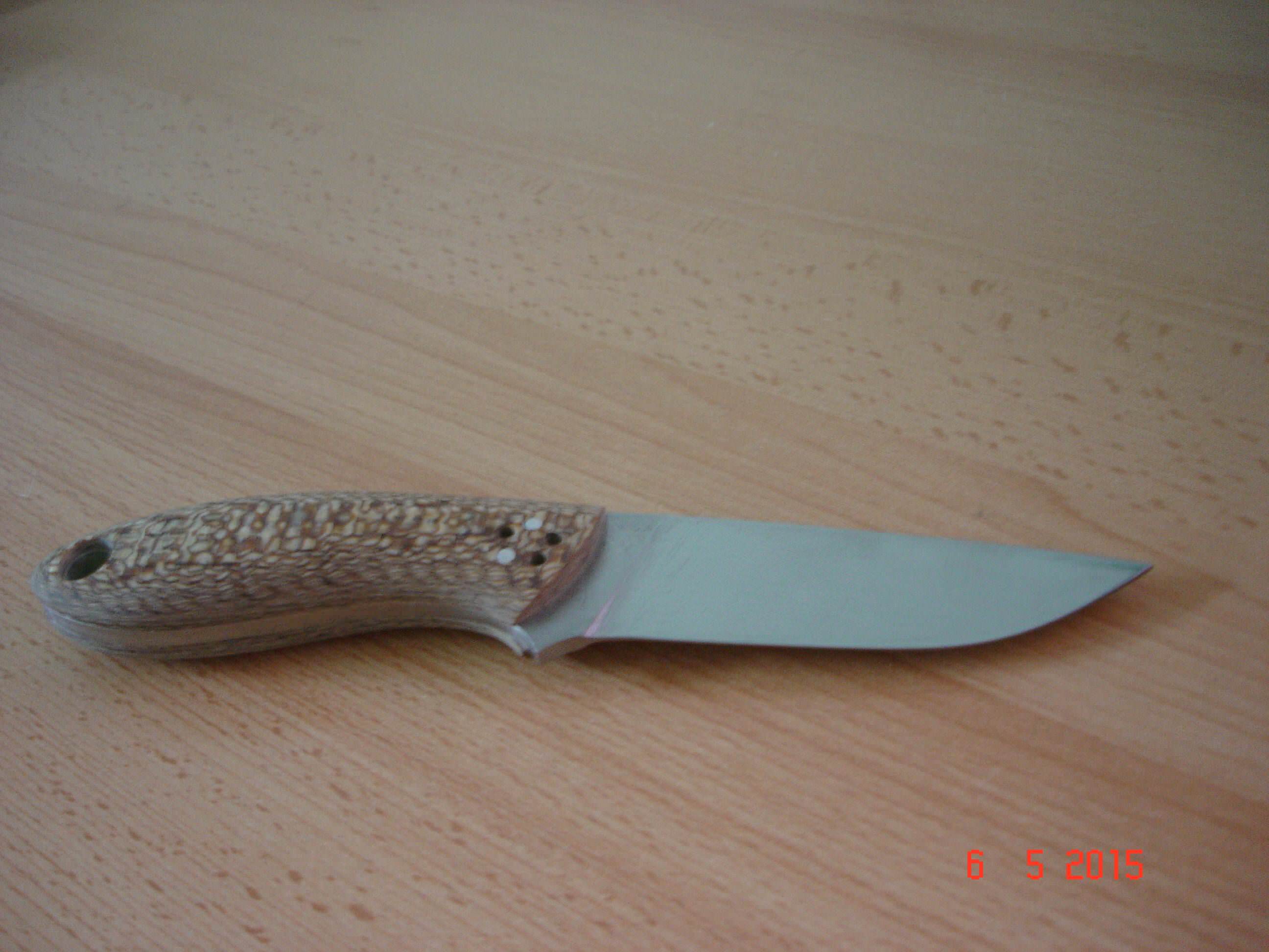

That's exactly how I worked ....blade was hard chrome and don t want to scratch finish ...
picture are before hard chrome
finished
