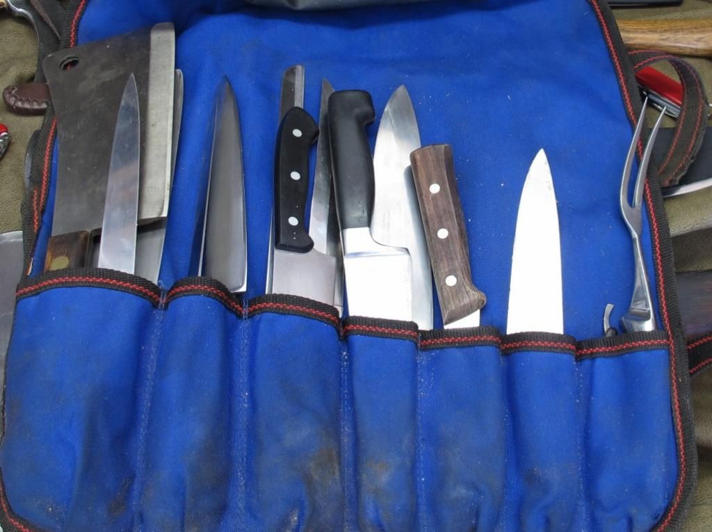

That knife would go straight to one of my rolls of old work knives, I already have a few that will do the same task. I still buy a good blade when I see it at the thrift shop or flea market, and I really don't need any, just ask my wife.:) I used to have an old Forshner curved flex boning knives just like the Rosewood handled knife in the pic but the blade was ground down to an ice pick with and edge, great for fine garnish work, I don't know what ever happened to it. I went to carve a pumpkin one Halloween and could not find it. Im slowly getting another one into shape, I'm about halfway there, and the one in the bag is for later modification through use.
They just become outdoor knives after a certain point for me, although most I've had in everyday service for over 10 years.
