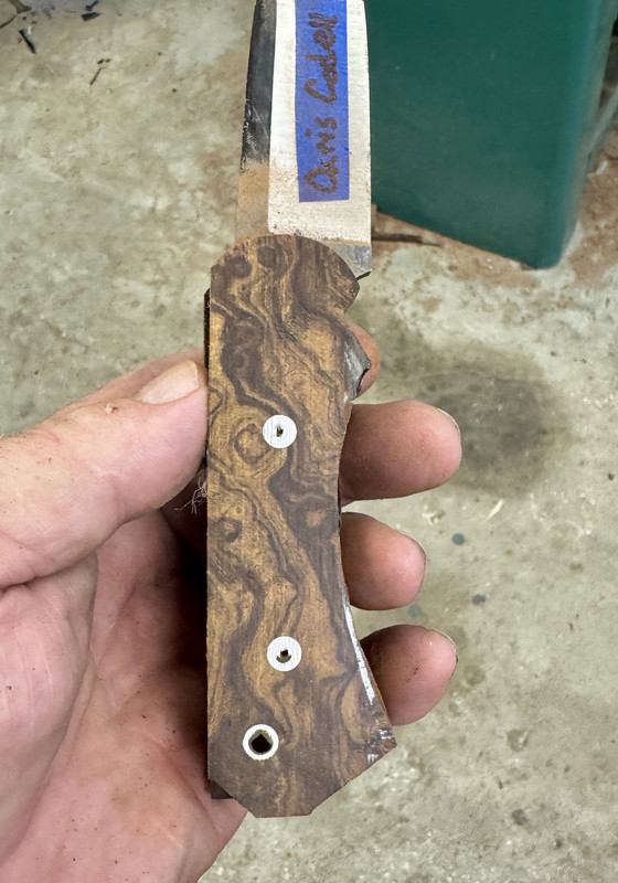

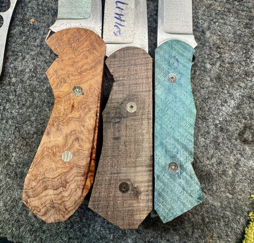

Nowhere to be found. Nobody's got em. Finally found one ten pair pack at Jantz at Blade Show for $42. Ruined four knives with those Chinese(?) bolts. The second I ground through the screw slots I hit "threads" . Spent all day yesterday milling out the stupid screws hoping to salvage the $$$ handle material. I was successful on 3/4. I've been buying from Pops for 40+ years and they are trying to set up making them, subbing it out to someone. Whomever it is, they can't find the motivation to begin learning the process.
You can always drill the center with a #30 and put a little bit of a 1/8" mosaic in there with superglue. Then finish er out like normal. Done carefully looks like it was made that way. Did one for cowboy bout 15 years ago now. He's been rough and tough on it as one would expect and no problems. I did it for the very same reason%$#@&^**(#$ reason. Anyhoo save ya some time and handle material

That was the issue Jess. The tapped hole was right below the screwdriver slot. Once you ground off the slot, you had zero room for further grinding. Very poorly designed by some maker that had no idea how things work with Corby bolts. That’s why I figured it was probably Chinese mfg.
If that is the case, then I absolutely agree that the bolts were made wrong. The hole should just barely enter the wider part of the head.
Drill the holes clean with a three flute bit or end mill and put colored epoxy in the holes is all you can do with these blades. Returning any unused Corbys to the manufacturer with a detailed description of the error in manufacture may also help future customers get an improved version.

Been buying the same ones from China for several years. They are not conventional Corbies with a male and female. They come as two male heads and a threaded tube. Tubes come in a couple of lengths. Absolutely no chance of grinding into a void. 300 series stainless and very well made.

You grind the male shanks down to be as short as needed, and grind the female tube to the thickness of the tang plus a tad less than the depth of the shank holes past the counterbore hole shoulders.
