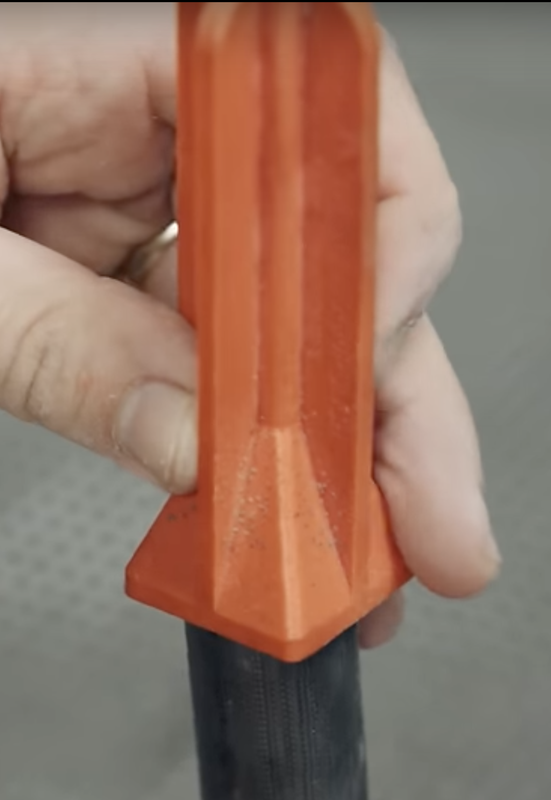

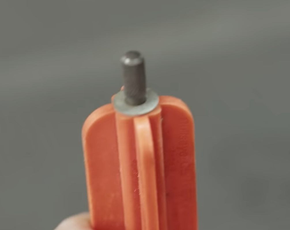

Does anyone know where I can find one of these?
It fits over the end of a 1/2" dowel/circular piece of material.
I'm sure they come in a set with different widths.
Thanks!
I don't know where to find that exact punch.
An alternate method to mark the center of a dowel would be to drill a ½ inch hole in a chunk of wood (face of a 2x4 perhaps), insert dowel part way through the hole, and use a ½ inch transfer punch to dimple the center of the dowel end.
Online search can find you a set of transfer punches for a bit over $10.
HTH.
Look at a site which sells tools for gunsmiths.
